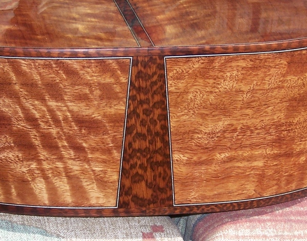

PostPosted: Wed Apr 25, 2007 2:09 pm
if you look around in the archives you will find some photos of end graft jigs which will allow variable angle including straight, and with modification to the guides could do paul's curved wonder as well.

PostPosted: Thu Apr 26, 2007 3:22 am
[QUOTE=Dave Stewart] I would have thought straight ones would be more difficult to fit accurately (whereas slightly angled ones can be wedged in so the seam is always perfect - assuming the graft & pocket angles are the same). No?[/QUOTE]
Dave, that is probably true. Another advantage of the wedge is that if the top and back center seams don't exactly match up it will be less noticeable if you use a wedge. I use both straight and angled ones depending on how accurate I have been up to that point...

PostPosted: Thu Apr 26, 2007 4:27 am
[QUOTE=Ricardo] Thanks all for the beautiful end grafts. Paul, could I suggest you show this beautiful end graft on your site? I went to your site because of your reputation but did not see pics of your end grafts. [/QUOTE]
KNow any web designers that are super cheap?

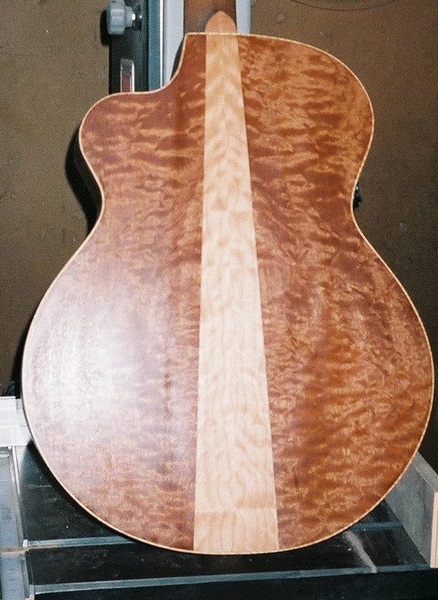

PostPosted: Thu Apr 26, 2007 11:30 pm
I like a slight taper... Simple and relatively painless to do...
Here's no.2
And no.3
